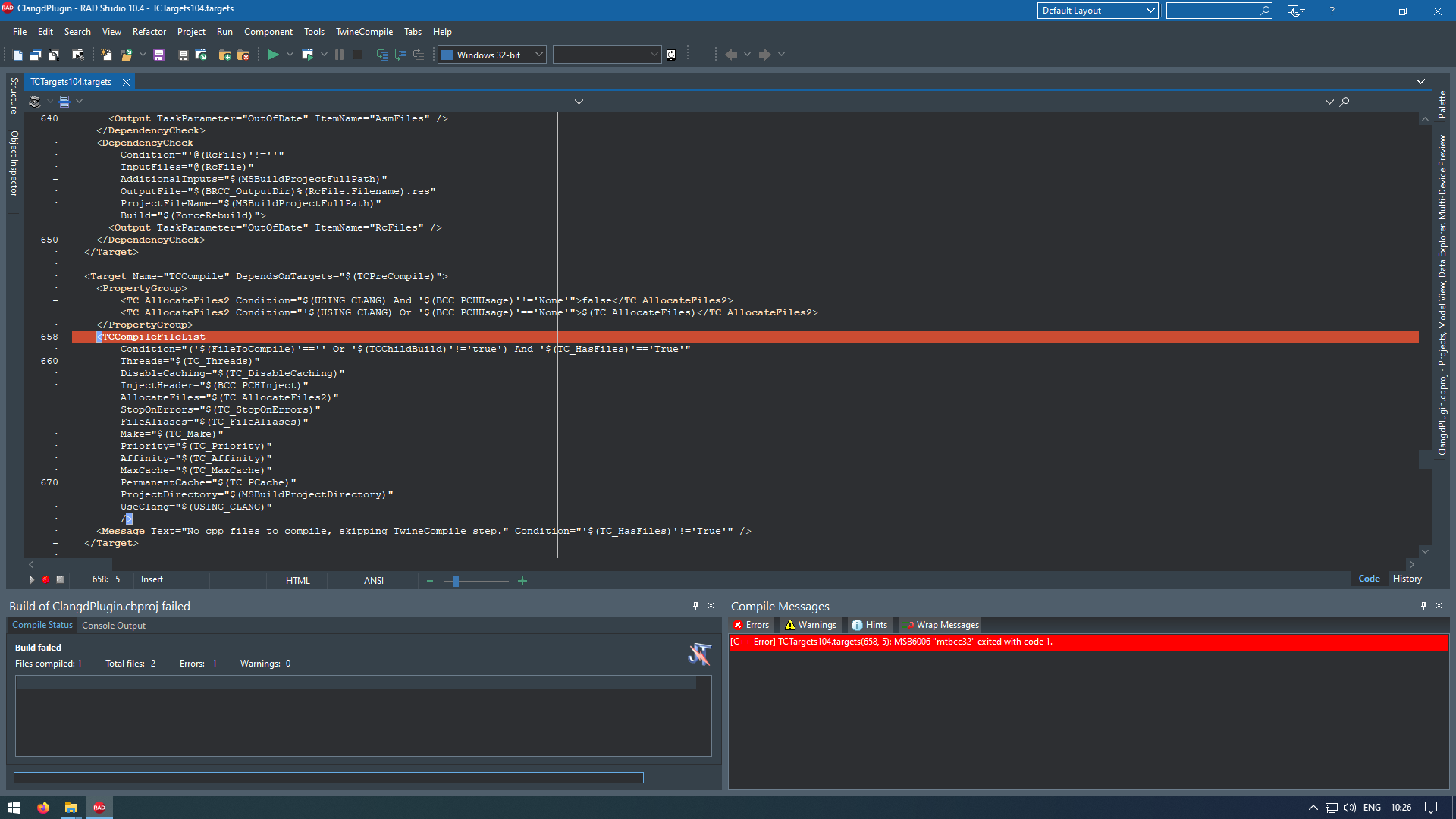

Hi,
when compiling with TwineCompile 5.2 i often get this error "[C++ Error] TCTargets104.targets(658, 5): MSB6006 "mtbcc32" exited with code 1." when doing "Build". If i try to "Make" the project after the error it compiles fine. I am using bcc32c and bcc64 compilers, i haven't tested this on the classic bcc32.
Another problem that occurred to me a couple of time is a linker error "unresolved vtable for TForm2" when I do "Make". If I then do a clean and build it compiles just fine. I'm not sure if this is related to TwineCompile. (I have proper configuration of output directories so i don't have a clue why this is happening).
Best regards!
(125.19 KiB) Not downloaded yet
