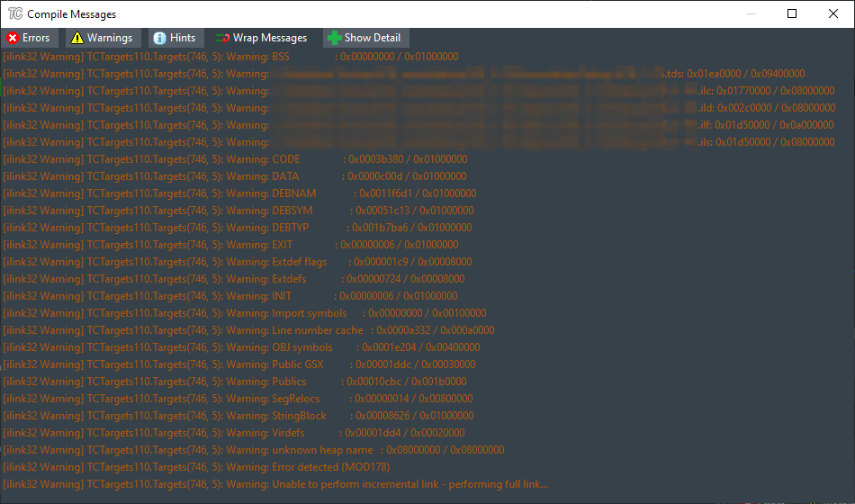

When using TwineCompile 5.3.0.9 with C++ Builder 11.0:
When I build a group project (from the IDE) with a clean and build, with two projects in it (1 executable and 1 dll), the executable does not get its icon compiled in it. So the icon is nowhere shown when looking at the exe or running it.
When I only build the project itself, it does however gets its icon.
When I first compile without TC and then make a small change in some file and compile again, but this time with TC, I get these warnings:
(65.47 KiB) Not downloaded yet
Maybe they have to do something with it.
