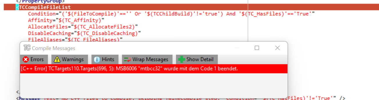

TwineCompile fails at any compilation attempt with this error:
The version available from GetIt is version 5.3.0, which does not seem to be suitable for RAD Studio 11.1

Same Problem here.
Here's a Picture of the Problem: Is there an eta when a new Version for the 11.1 Release is planned?

Re: RAD Studio 11.1
TwineCompile 5.4 with support for RAD Studio 11.1 has just been released. Please go to GetIt and download this new version.
